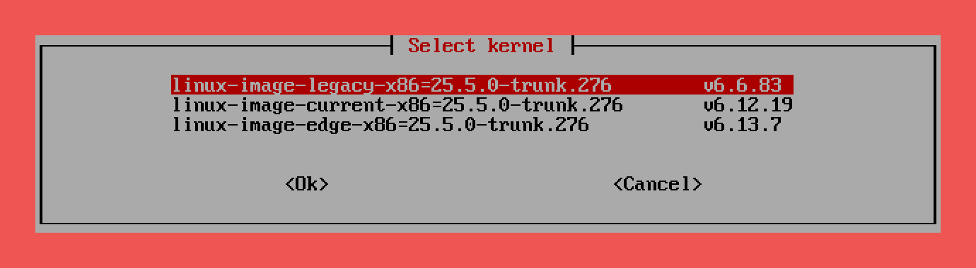

Alternative kernels
Use alternative kernels
Alternative kernels
Switching between different kernel versions can significantly impact the functionality of your device. A newer or older kernel may introduce changes to hardware compatibility, drivers, and system stability. Some features may stop working, while others may improve or be reintroduced.
Kernel changes carry inherent risks!
  • A mismatched or incompatible kernel may result in boot failures, rendering the system unresponsive.
  • Certain peripherals or hardware components (e.g., Wi-Fi, GPU acceleration, or power management) may no longer function correctly.
  • Custom configurations or third-party modules might need to be recompiled or adjusted to work with the new kernel.

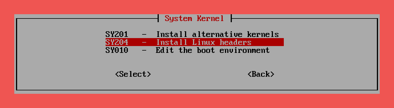

armbian-config --cmd KER001
Kernel Headers
Install Linux headers
Kernel Headers
Kernel headers are files required to build modules (drivers) or software that interfaces directly with the Linux kernel. Installing headers ensures compatibility when compiling custom drivers, DKMS modules (like ZFS, WireGuard), or updating third-party software that requires access to kernel internals. The installed headers match your running kernel version and are critical for system extensions and hardware support.

armbian-config --cmd HEAD01
Remove Headers:
armbian-config --cmd HEAD02

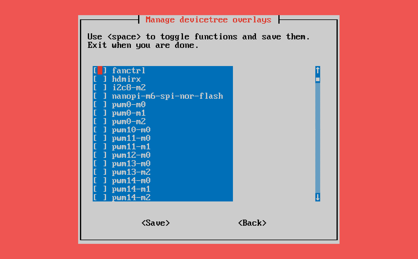

Device Tree Overlays
Manage device tree overlays
Device Tree Overlays allow you to dynamically modify the Linux device tree at runtime, without rebuilding the kernel. They are used to enable or configure specific hardware features (like GPIO pins, I²C, SPI, sensors, displays) on single-board computers. Overlays are small snippets that can add, change, or remove parts of the hardware description, making it flexible to adapt the system for different peripherals without recompiling the full device tree.

armbian-config --cmd DTO001

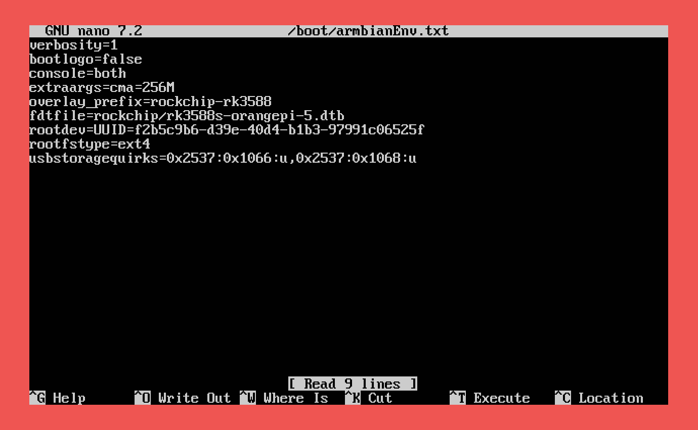

  • Select and edit any DTB file from the device tree directory
  • Edit active DTB directly based on the fdtfile setting in /boot/armbianEnv.txt
  • Automatic backups before every modification with timestamped filenames
  • Restore from backup to revert to a previous device tree
  • Validation of edited DTS source before applying changes
  • View device tree info including model, compatible strings, and DTC version
  • Package: device-tree-compiler (installed automatically if missing)
  • Device tree directory: /boot/dtb/
Backups are stored in /boot/dtb/backup/ with the naming format:
Text Only
<original-name>.dtb.<YYYYMMDD_HHMMSS>.bak

Boot Environment
Edit the boot environment
Boot Environment
Edit the boot environment allows you to modify critical boot settings stored in /boot/armbianEnv.txt. You can adjust options such as root filesystem location, kernel parameters, overlays, boot targets, or enable advanced features like early serial console. This is essential for fine-tuning hardware support, troubleshooting, or optimizing system startup behavior.
